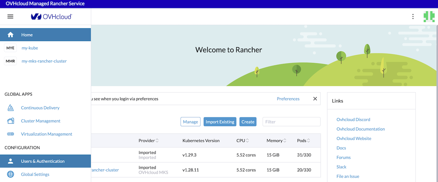

Log in to your Managed Rancher Service UI.
Rancher UI Homepage
In the menu, click on Users & Authentication.

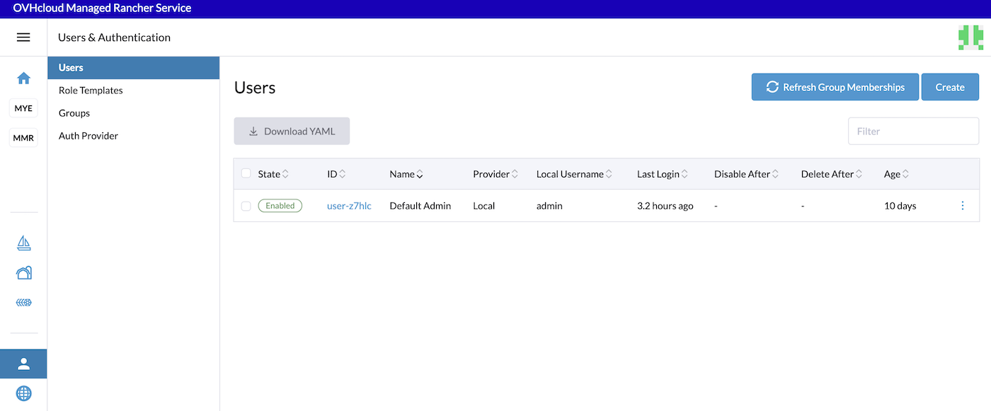

A list of existing users is displayed. You should have at least a Default Admin user.
To create a new user, click on the Create button.
Rancher UI Users

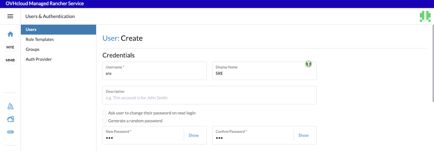

Fill in the username, a new password and confirm the password. You can also optionally enter a display name and a description.
Rancher UI SRE User
WARNING
The password needs to have at least 12 characters.

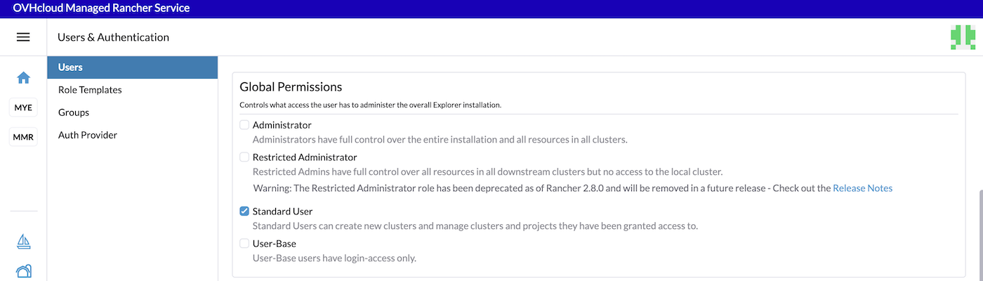

Rancher has several levels of global permissions. If your user needs rights to create and managed new clusters, you can choose Standard User global permission.
Rancher UI Standard User
Please refer to the official documentation to know more about global permissions.
Once you chose the initial permission, if you want fine-grained built-in roles, click the Create button.

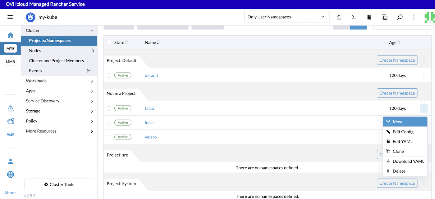

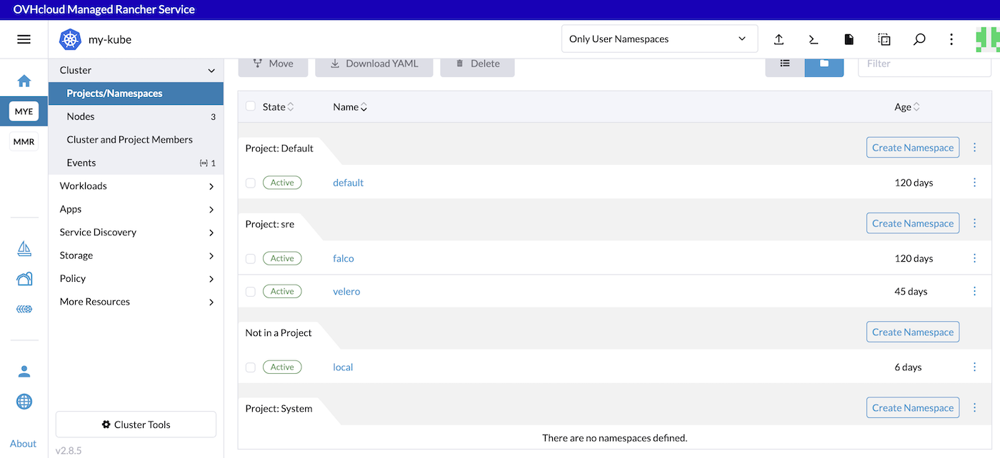

In the Cluster menu, click on Projects/Namespaces.
Rancher UI Homepage
You can see that our example cluster has several existing projects: Default and System. The Default project contains the default namespace and there are several namespaces that are not in a project.

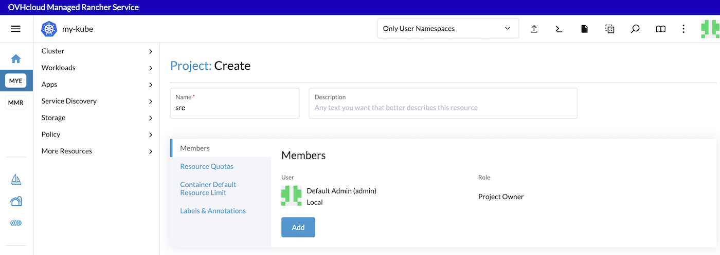

Click the Create Project button.

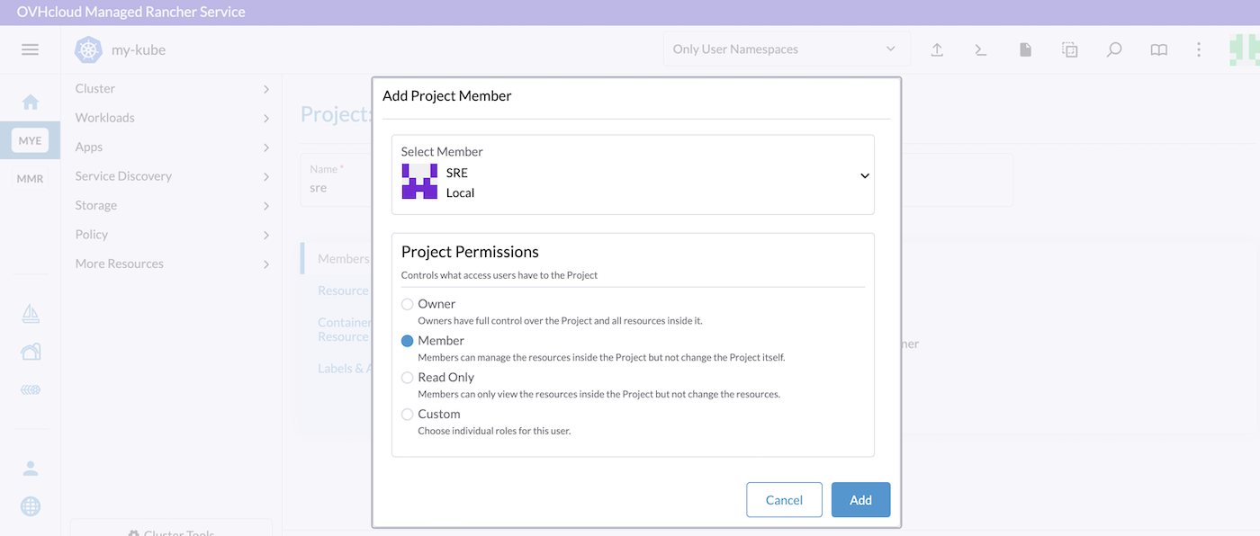

Enter the name of the project then click the Add button to add a member to the sre project.
Rancher UI Project
Select the user sre you previously created and select the project permissions. You can select the Member permission if you want a user that can manage the resources inside the project but not the project itself.
Rancher UI Project SRE
Then click the Add button to add the member to the project.
Finally, click the Create button to create the project.
To move the existing wanted namespaces in your sre project, click on the three dots button and click on Move.
Select the project then click the Move button to move the falco namepace in your project.
You can do the same thing for all of the namespaces you want.
