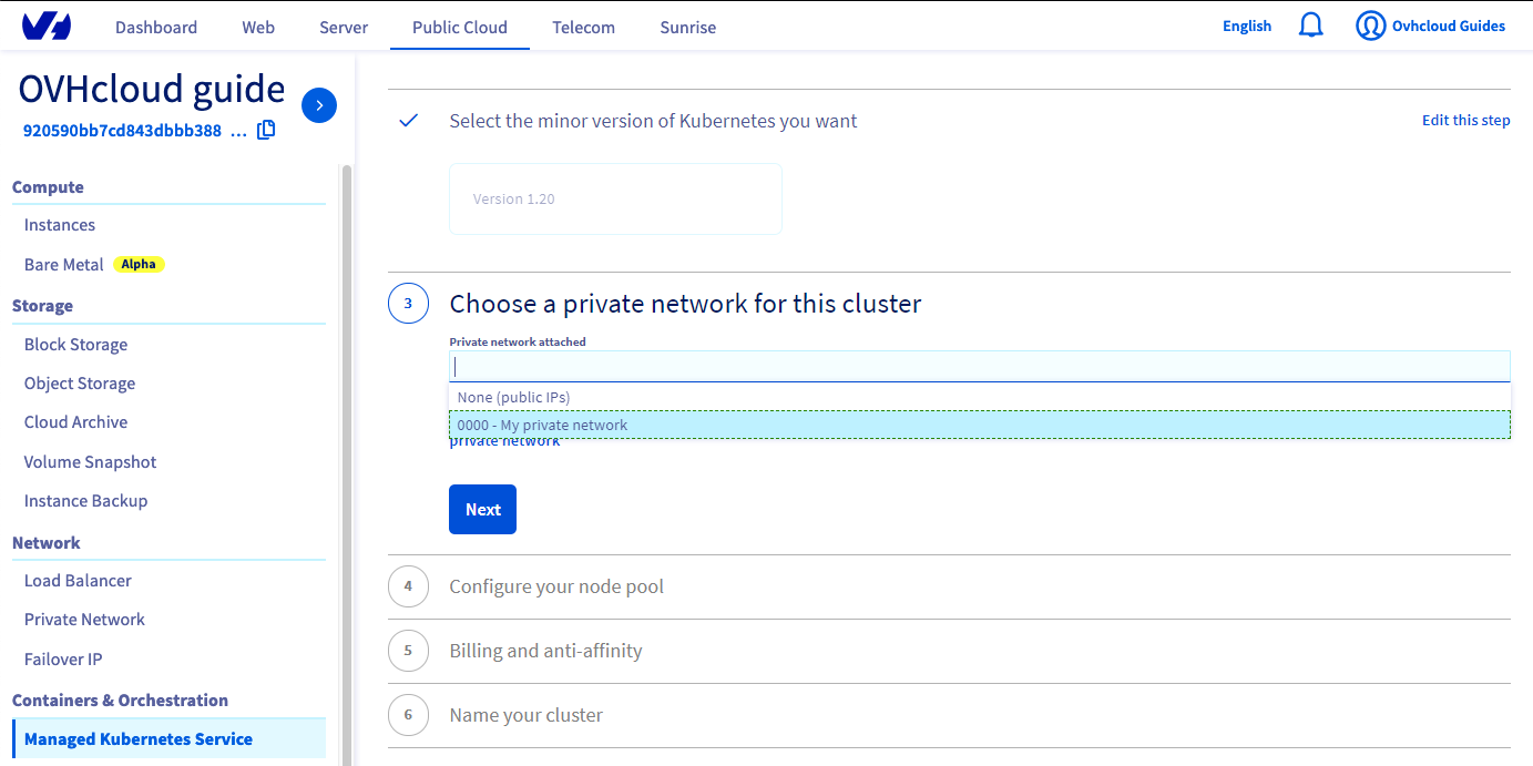

Integrating a cluster into a vRack private network must be done at the third step on cluster creation, when you can choose an existing private network for the cluster:
Choose a private network for this cluster
Your new cluster will be created inside the vRack private network you have chosen.
