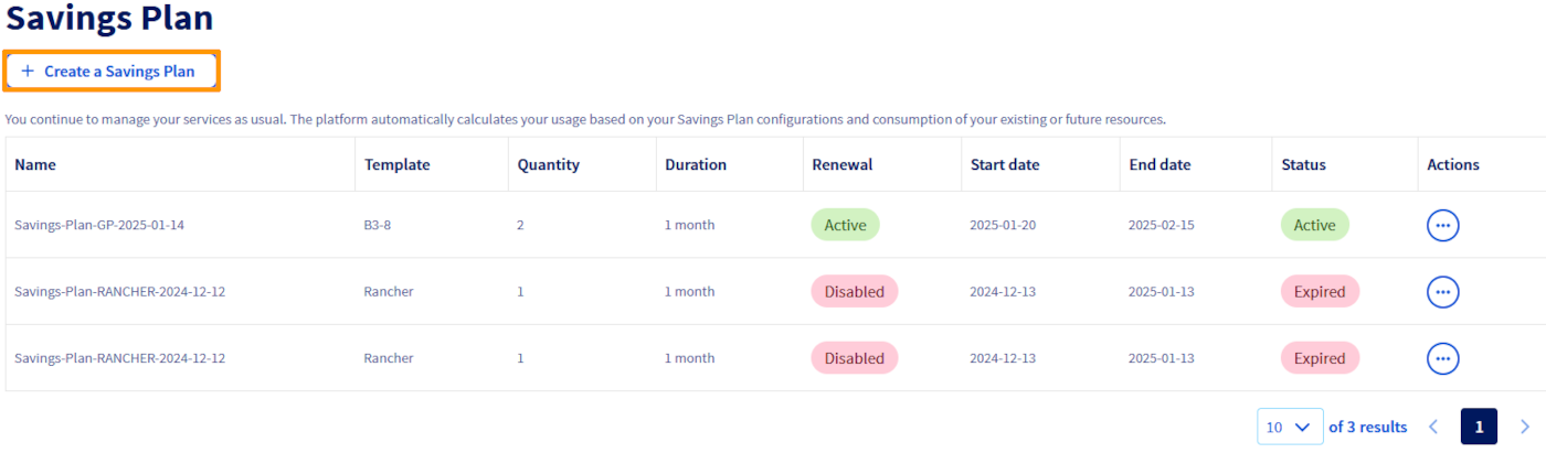

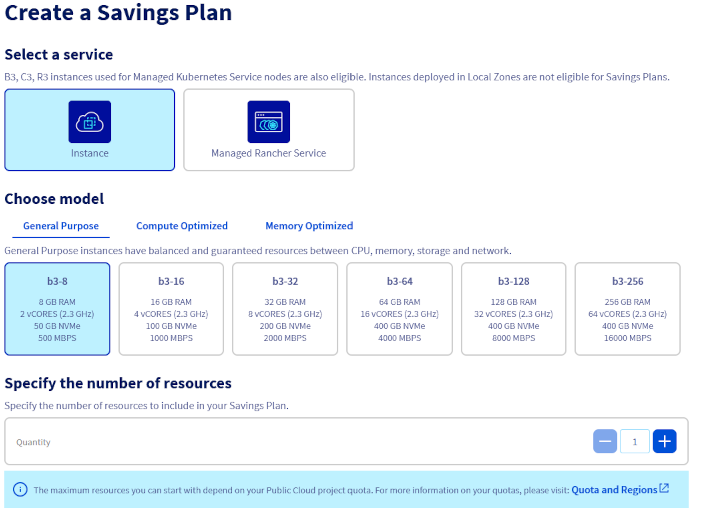

You can create your Savings Plan for the type of resource you want by following these steps:
Click the Create a Savings Plan button.

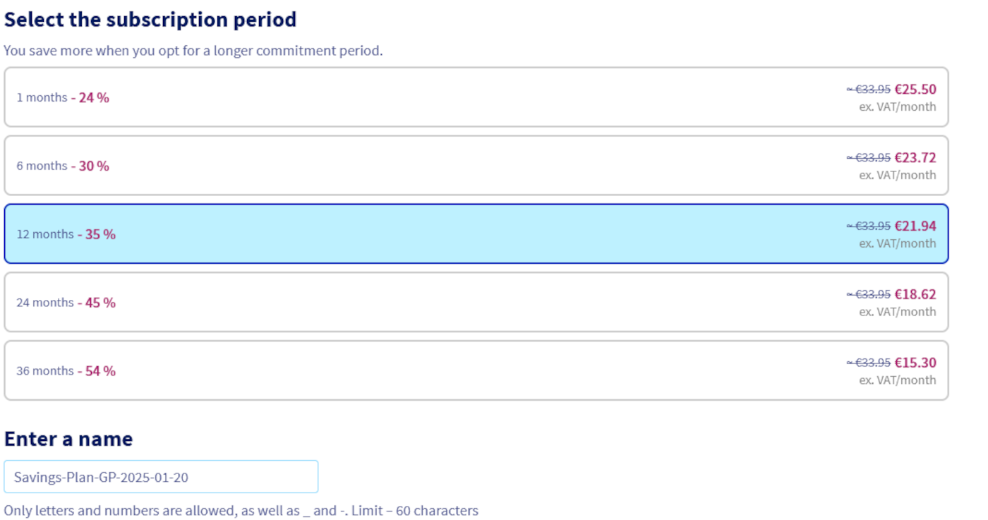

Select the type of resource for which the Savings Plan will apply, define the specific resource model and specify the number of resources affected by this plan.
Choose the duration of your Savings Plan from the available durations and give it a name.

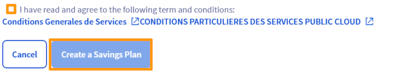

Read the Terms and Conditions carefully, then tick the box to confirm you accept them. Once all the parameters have been configured, click the Create a Savings Plan button to finalise the creation.

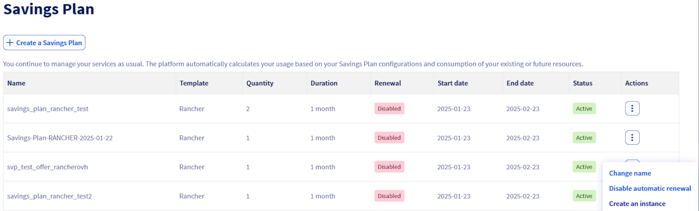

Modifying a Savings plan
INFO

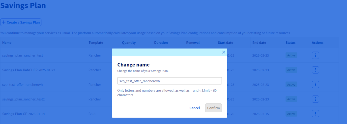

Using the OVHcloud Control Panel, you can only edit the name of the Savings Plan and activate/deactivate its automatic renewal.
If you wish to change the name, click the Change name button, change the name and then click Confirm.

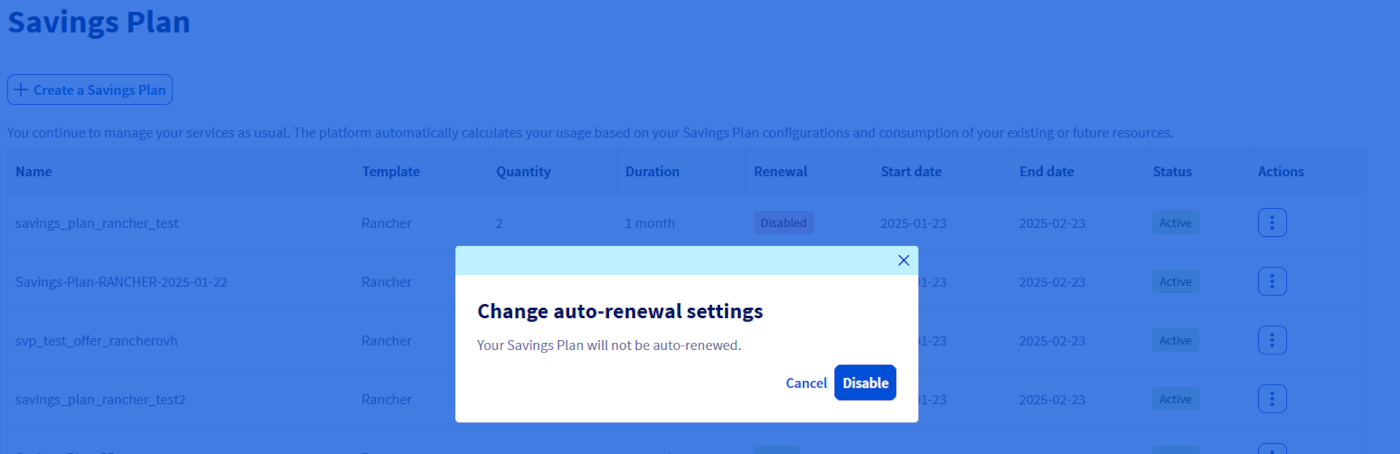

If you wish to activate/deactivate the automatic renewal of your Savings Plan, click on the Activate/Disable automatic renewal button and then on the Activate / Disable button as appropriate.

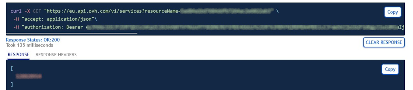

First find the id of your service in the list of your services, which can be obtained via the following endpoint:
🇪🇺 EU 🇨🇦 CA 🇺🇸 US GET /services You must enter the id of your Public Cloud project as a parameter in the resourceName field.
You will obtain a list containing the id of your services as follows:

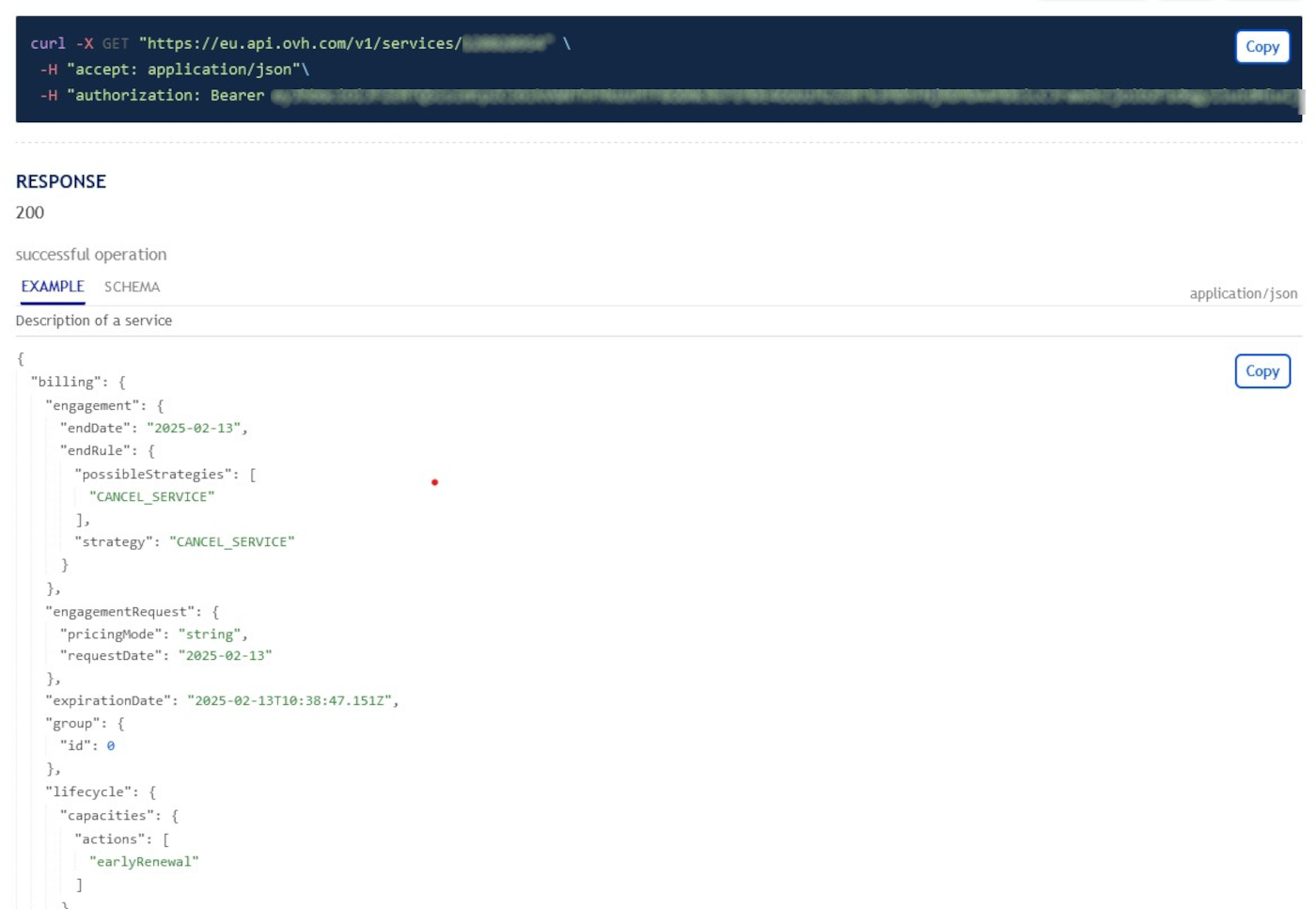

You can use this route to check whether the service corresponds to the Public Cloud project concerned:
🇪🇺 EU 🇨🇦 CA 🇺🇸 US GET /services/{serviceId} The serviceId corresponds to the id retrieved with the previous endpoint.
You'll get a list containing the details of your service as follows. Check that it's the right project, using the vars.value field:

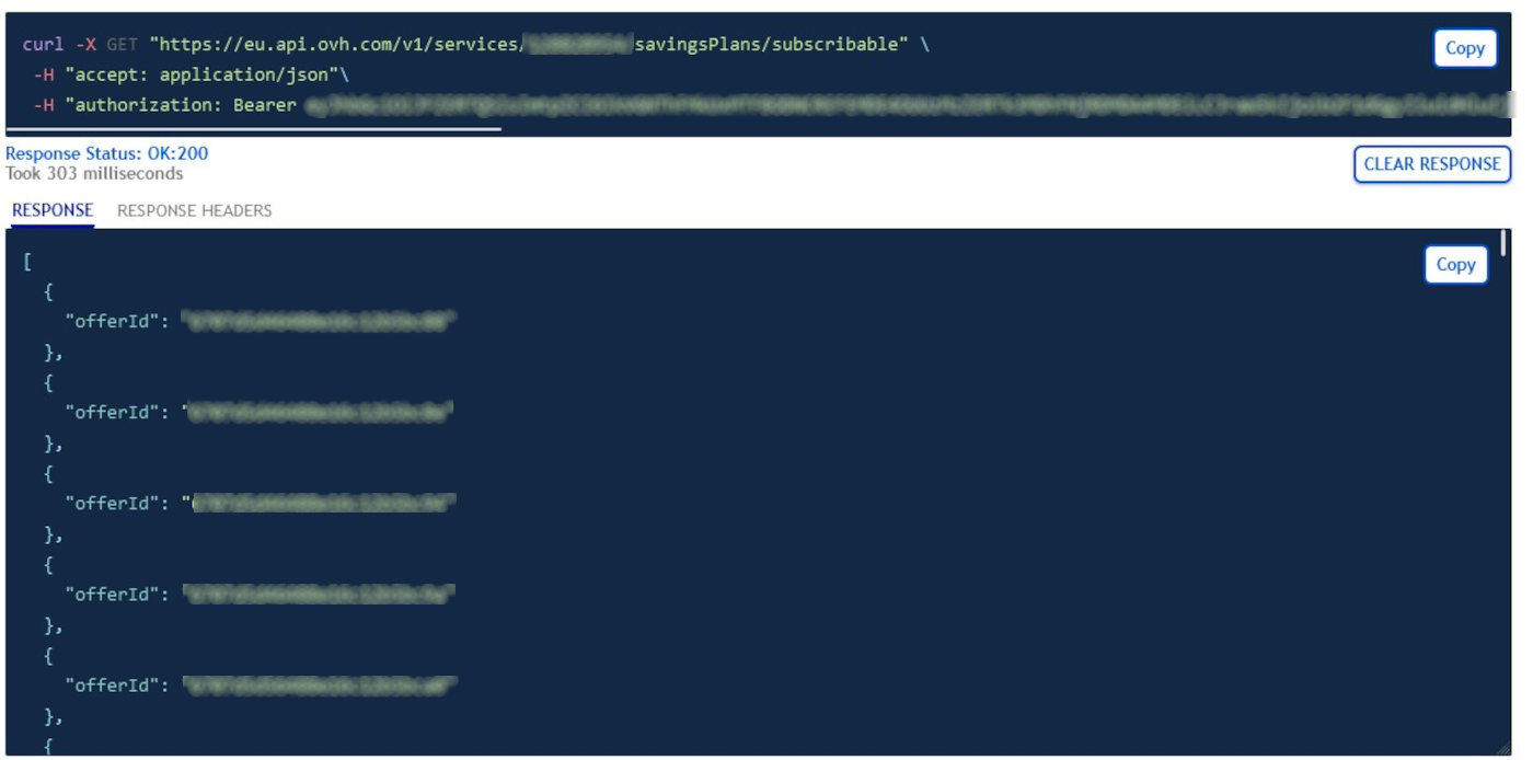

You can find the id of your Savings Plan in the list of your Savings Plans obtained via this endpoint:
The serviceId corresponds to the previously retrieved id.
You get a list of Savings Plan as follows:
Then look for the Savings Plan concerned in the list and copy its id .
