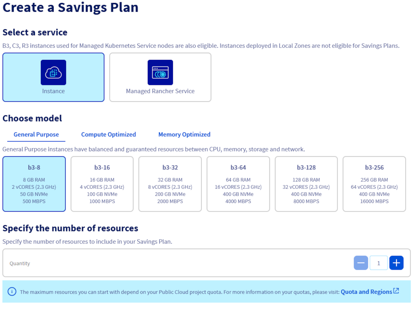

You can create your Savings Plan for the type of resource you want by following these steps:
Via the OVHcloud Control Panel
Via Terraform

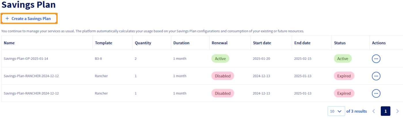

Click the Create a Savings Plan button.
Select the type of resource for which the Savings Plan will apply, define the specific resource model and specify the number of resources affected by this plan.

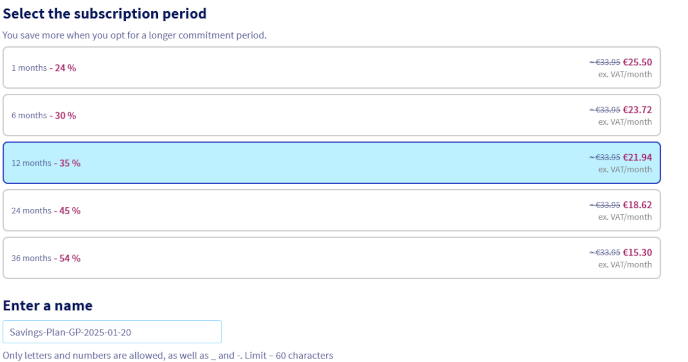

Choose the duration of your Savings Plan from the available durations and give it a name.

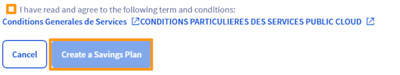

Read the Terms and Conditions carefully, then tick the box to confirm you accept them. Once all the parameters have been configured, click the Create a Savings Plan button to finalise the creation.

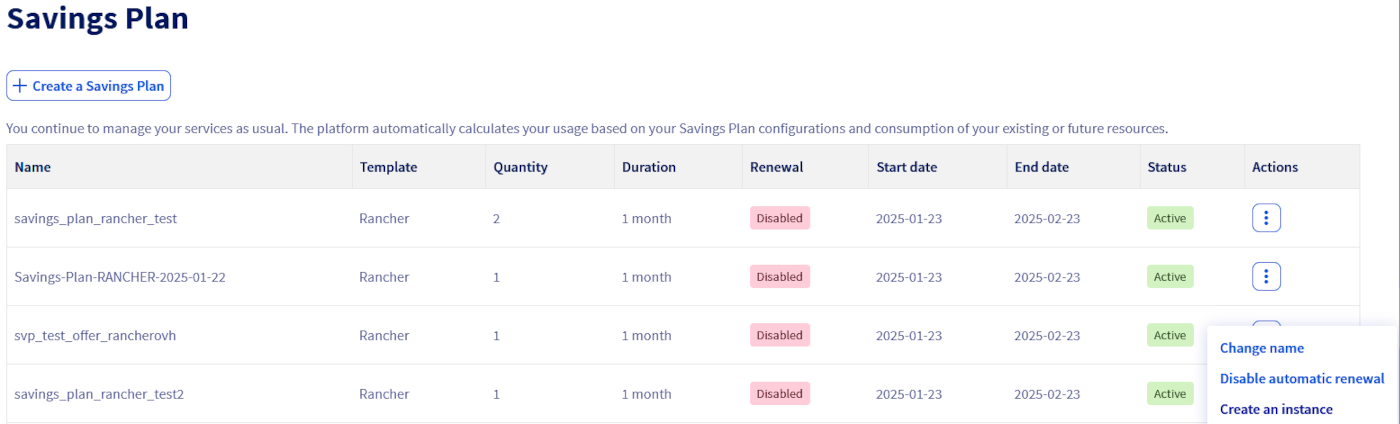

Modifying a Savings plan
Via the OVHcloud API
Via Terraform
INFO

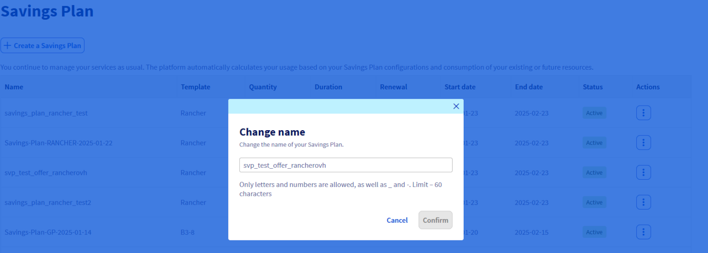

Using the OVHcloud Control Panel, you can only edit the name of the Savings Plan and activate/deactivate its automatic renewal.
If you wish to change the name, click the Change name button, change the name and then click Confirm.

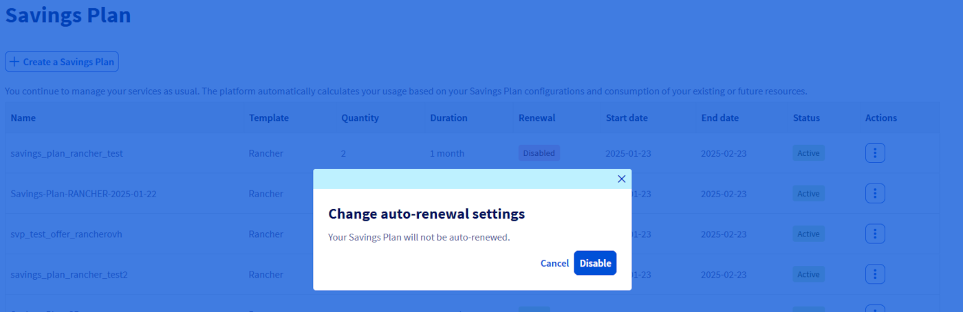

If you wish to activate/deactivate the automatic renewal of your Savings Plan, click on the Activate/Disable automatic renewal button and then on the Activate / Disable button as appropriate.

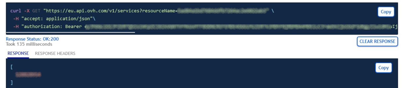

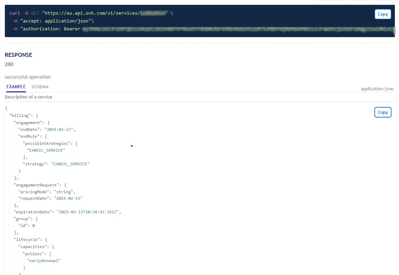

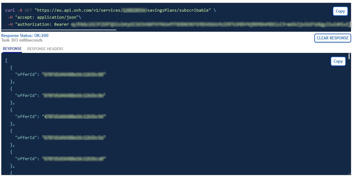

First find the id of your service in the list of your services, which can be obtained via the following endpoint:
2 minutes · Anonymous
